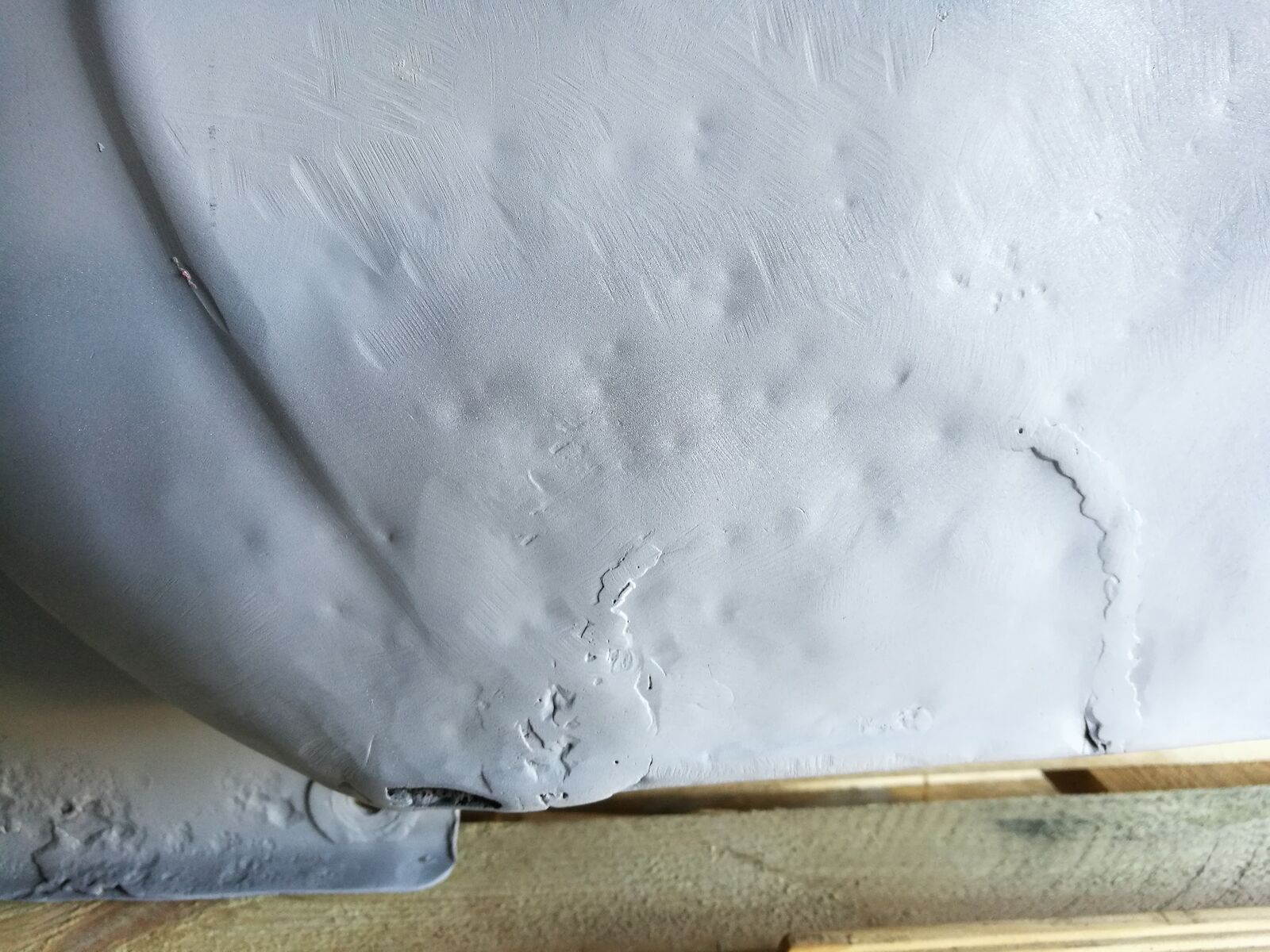

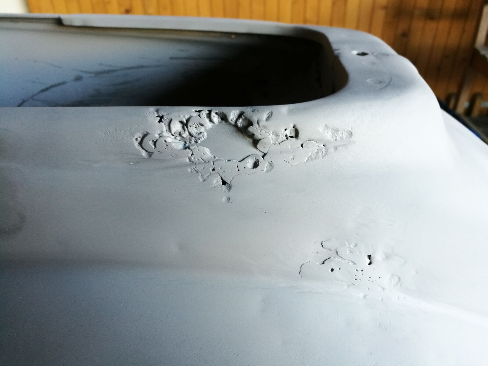

  • 50N Blankes Blech
    • bull
    • October 12, 2017 at 13:44
    Nicht gut!
      • 142.65 kB
  • 50N Blankes Blech
    • bull
    • October 12, 2017 at 13:39
    Nicht gut!
      • 248.67 kB
  • 50N Blankes Blech
    • bull
    • October 12, 2017 at 13:37
    Nicht gut!
      • 199.59 kB
