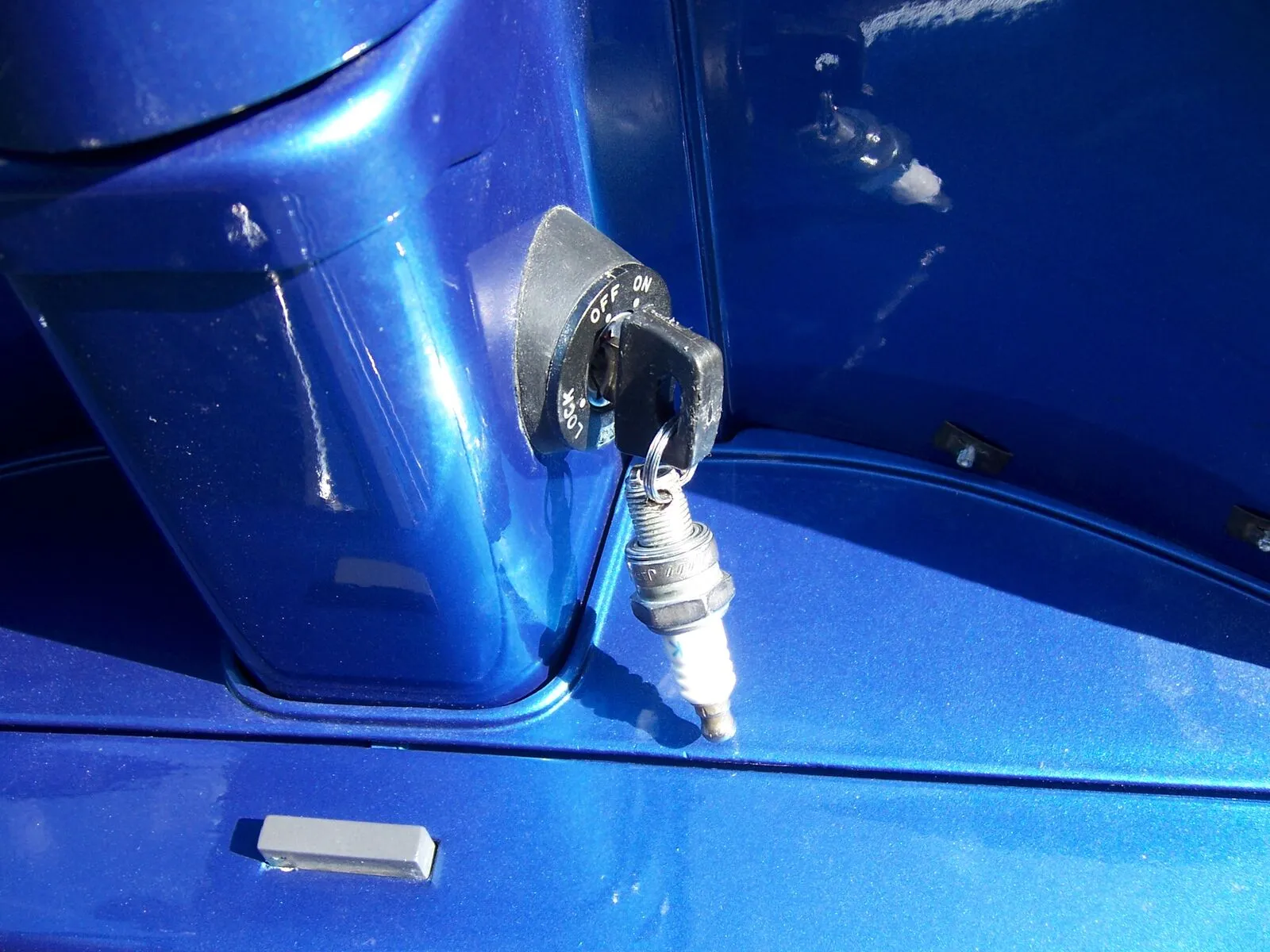

    • April 3, 2009 at 17:35
    Ich habe da so Klammern: (im Bild rechts mitte)
    The difference between men and boys is the price of the toys

    • April 3, 2009 at 20:20
    @ monsterbeetle
    Geiler Schlüsselanhänger :D
