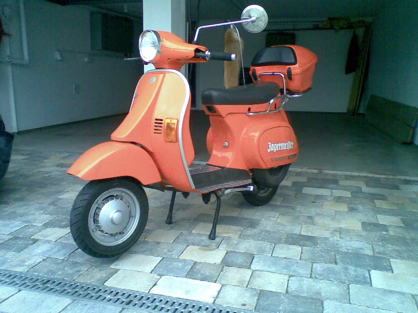

    • May 30, 2009 at 09:35
    Hier mein Moped!
