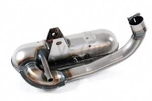

    • June 27, 2011 at 16:58
    hab noch nen original auspuff :)
