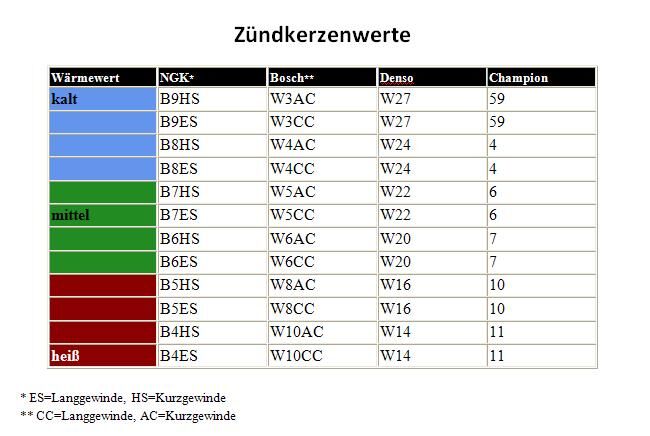

    • August 20, 2010 at 16:32
      • 42.39 kB
      • 650 × 436
      • 2,378
