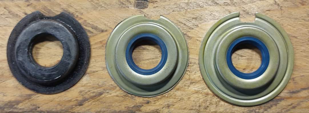

    Hi Simonen,
    i will check my SIP or Scootercenter account. Bought the seals in 2022

    this one?

    Wellendichtringsatz Motor 20x40x6/ 20x40x6/ 27x42x10 mm 610052M001 blau Note 1 - perfekte Reparatur | SIP-Scootershop
    !!!! you have to adjust the outside diameter!!!!!
