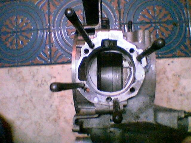

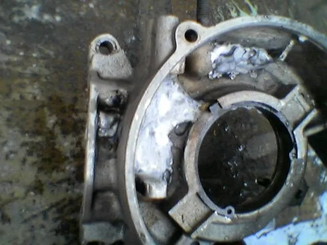

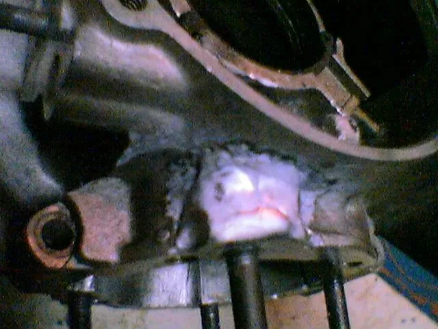

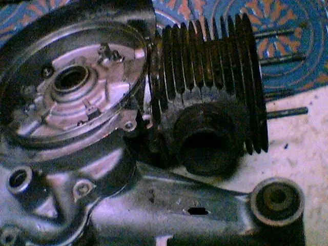

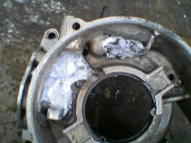

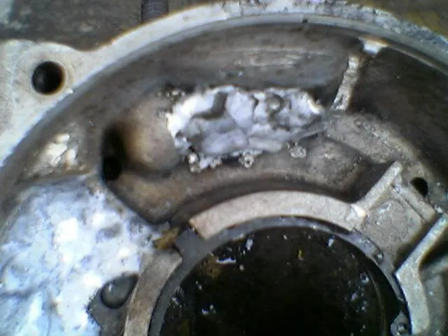

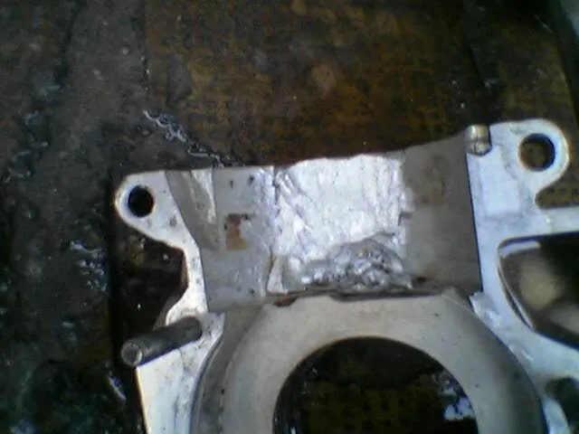

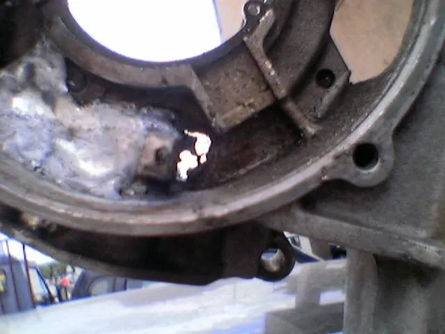

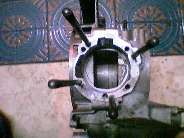

    • October 31, 2006 at 23:43

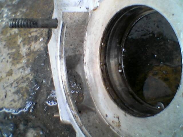

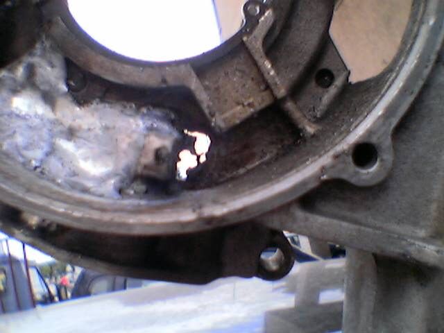

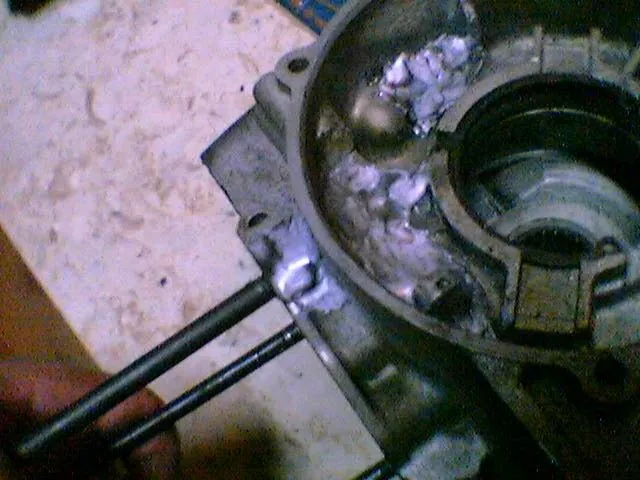

    from 125 ccm to 200 ccm enginecases ...
      • 36.37 kB
      • 640 × 480
      • 539
      • 43.41 kB
      • 640 × 480
      • 546
      • 42.12 kB
      • 640 × 480
      • 533
      • 33.72 kB
      • 640 × 480
      • 526

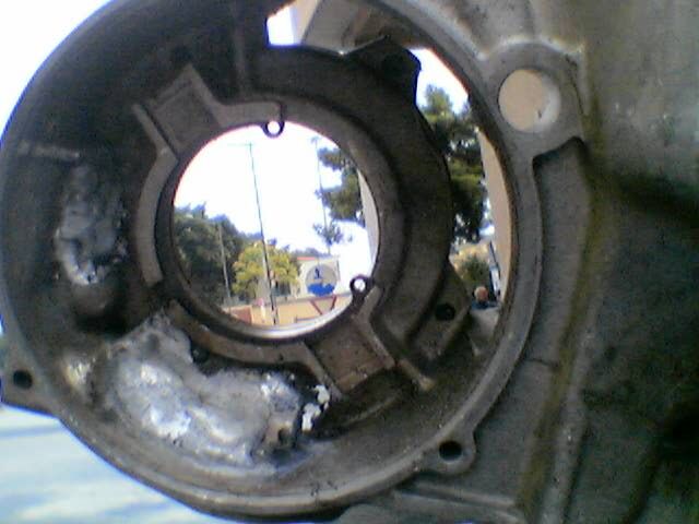

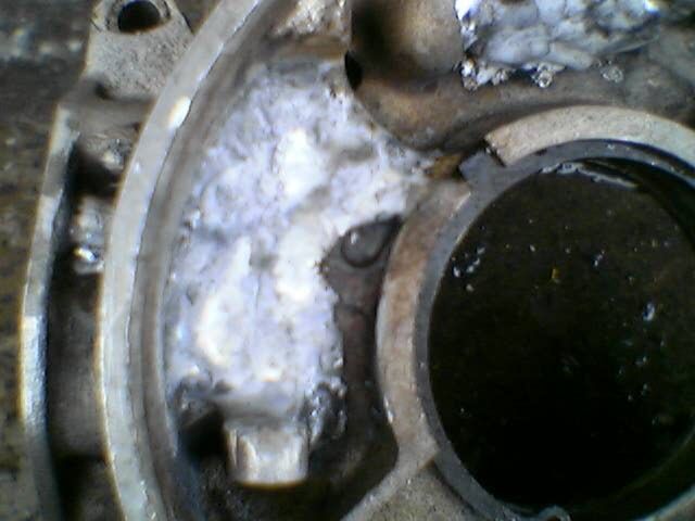

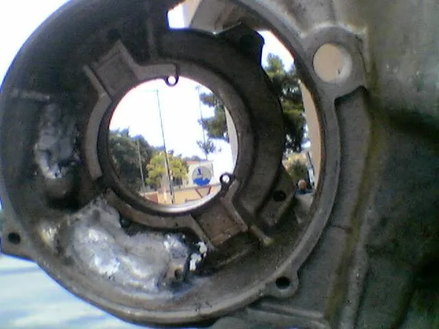

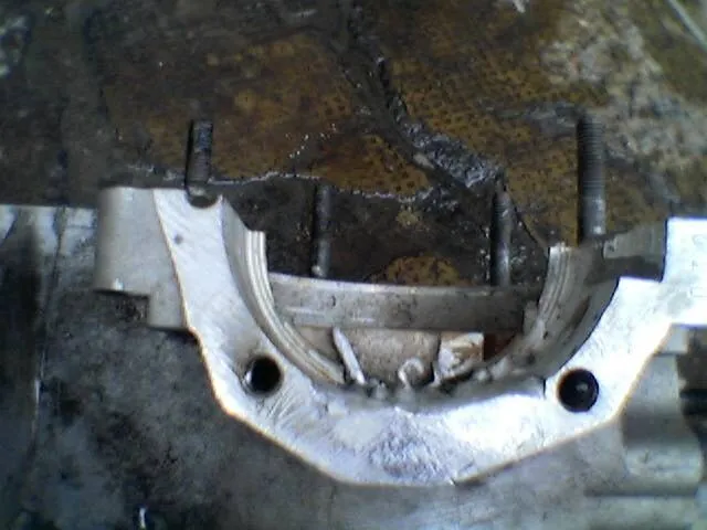

    • October 31, 2006 at 23:45

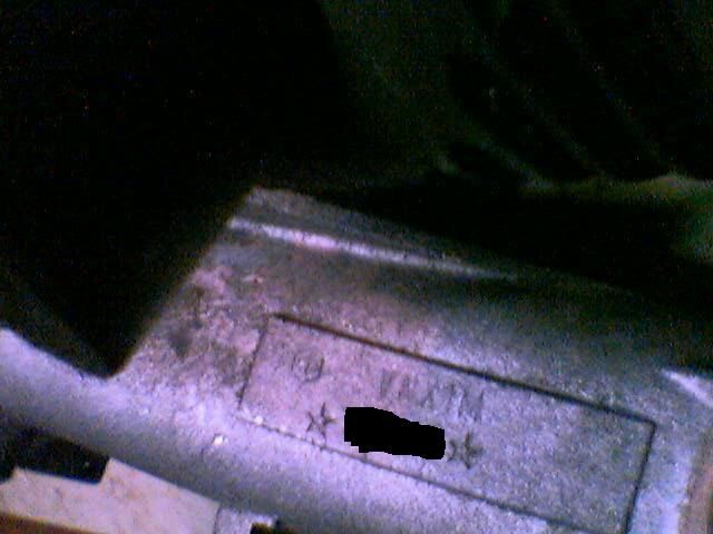

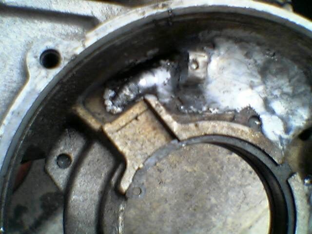

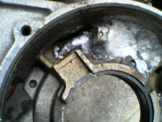

    other pictures ...
      • 39.59 kB
      • 640 × 480
      • 538
      • 39.39 kB
      • 640 × 480
      • 515
      • 40.81 kB
      • 640 × 480
      • 524
      • 34.89 kB
      • 640 × 480
      • 494
      • 39.05 kB
      • 640 × 480
      • 516

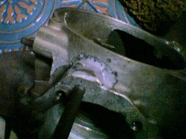

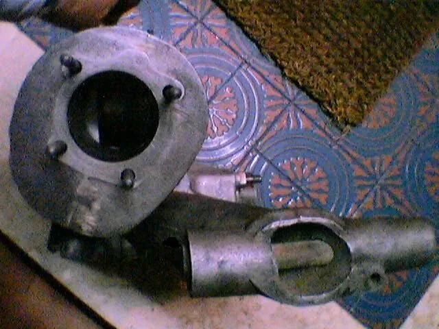

    • October 31, 2006 at 23:46

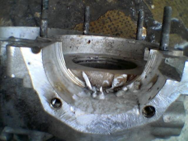

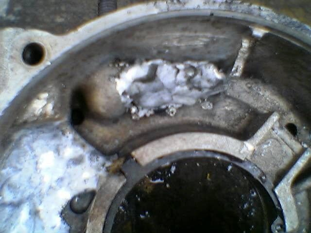

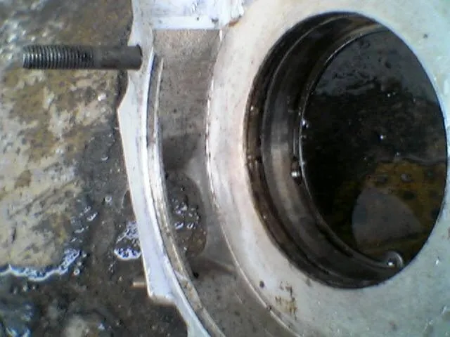

    .. others again ...
      • 43.27 kB
      • 640 × 480
      • 480
      • 49.93 kB
      • 640 × 480
      • 520
      • 49.85 kB
      • 640 × 480
      • 507
      • 49.63 kB
      • 640 × 480
      • 502
      • 54.14 kB
      • 640 × 480
      • 525

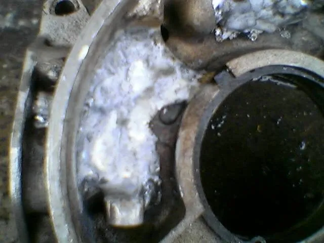

    • October 31, 2006 at 23:52

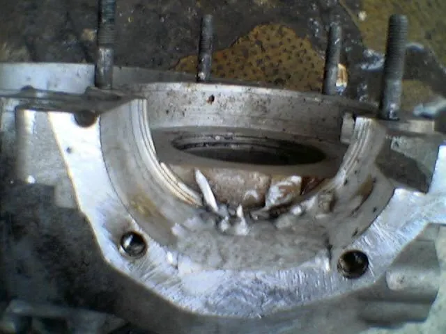

    so you can see starting from VNX enginecases now I can mount 200's cylinder (VSE).
    I hope that I didn't understand what you wrote; I don't speak German, so if I misunderstood your message you can erase my pictures and please excuse me.

    • November 1, 2006 at 00:06
    @ kl01:
    I fear you did actually get it wrong!
    The Problem was to get it backwards from 200ccm down to 125ccm!

    • November 2, 2006 at 20:27
    Original von Nick50XL
    @ kl01:
    Now I understand!
    Thank you.
    I think it should be easier, the main problem should be the inlet port (valvle), it's bigger and different in 200's enginecases.
    The crank:
    in 125/150 is like in 200 in the right side, near the flywheel;
    the other side, on the left, near the clutch, is different and I think you must keep the 200's side, it's larger than 125/150's side;
    the conrod is different, 200's conrod is longer (110 mm) than 125/150's conrod (105 mm) and the piston's hole is bigger (200 --> 16 mm, 125/150 --> 15 mm).
    SO you should mount a 125/150's conrod on the 200's cranck.
    Than you need something to adapt the bigger 200's hole for cylinder to the 125/150 cylinder, and put on it the new studs cylinder (in 200's engine are 4 x M8*160, in 125/150 4 studs M7*140); you must fix the adaptor in the enginecases.
    So you could put a 125/150 ccm cylinder on 200's einginecases. You will have the inlet port (valvle) bigger than a 125/150's engine.
    This is only my opinion, of course.
    O.T.: I'm in Palermo - Sicilia -Italia
    Einmal editiert, zuletzt von kl01 (November 2, 2006 at 20:28)

    • November 3, 2006 at 12:30
    You actually really thought about that stuff, didn't you?
    After all you pointed it should be easier to mount a complete 125ccm engine than to stuf it together. And that was what we were talking about, for there is no cylinder-kit fitting on the 200-engine!

    • November 3, 2006 at 15:41
    No worrys Mate
    Thx 4 loading up your engineshoots.
    Quiet interesting how mutch effort you took to fit in the Zylinder.
    I prefer the KISS System cause I such a lazy fart :D
    Iit seems you got acces 2 a Alloy Welding machine,you lucky bastard
    Also I dont know how mutch a used 200ccm egngine would cost in South Italy
    But even in Germany (recently around 350€) the prices are far to high.
    Thats why I started 2 fit in Cosa engine in PX Frames.
    Cheers Ante
