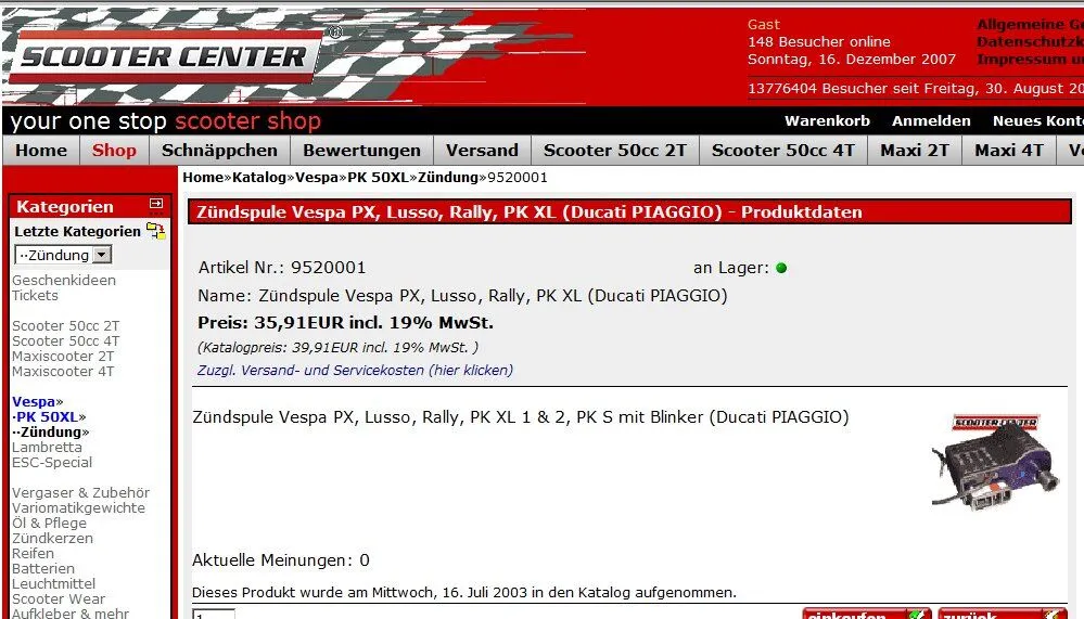

    • December 16, 2007 at 10:44
    Hi, Nicht gefunden?????? schau mal!
    klaus
