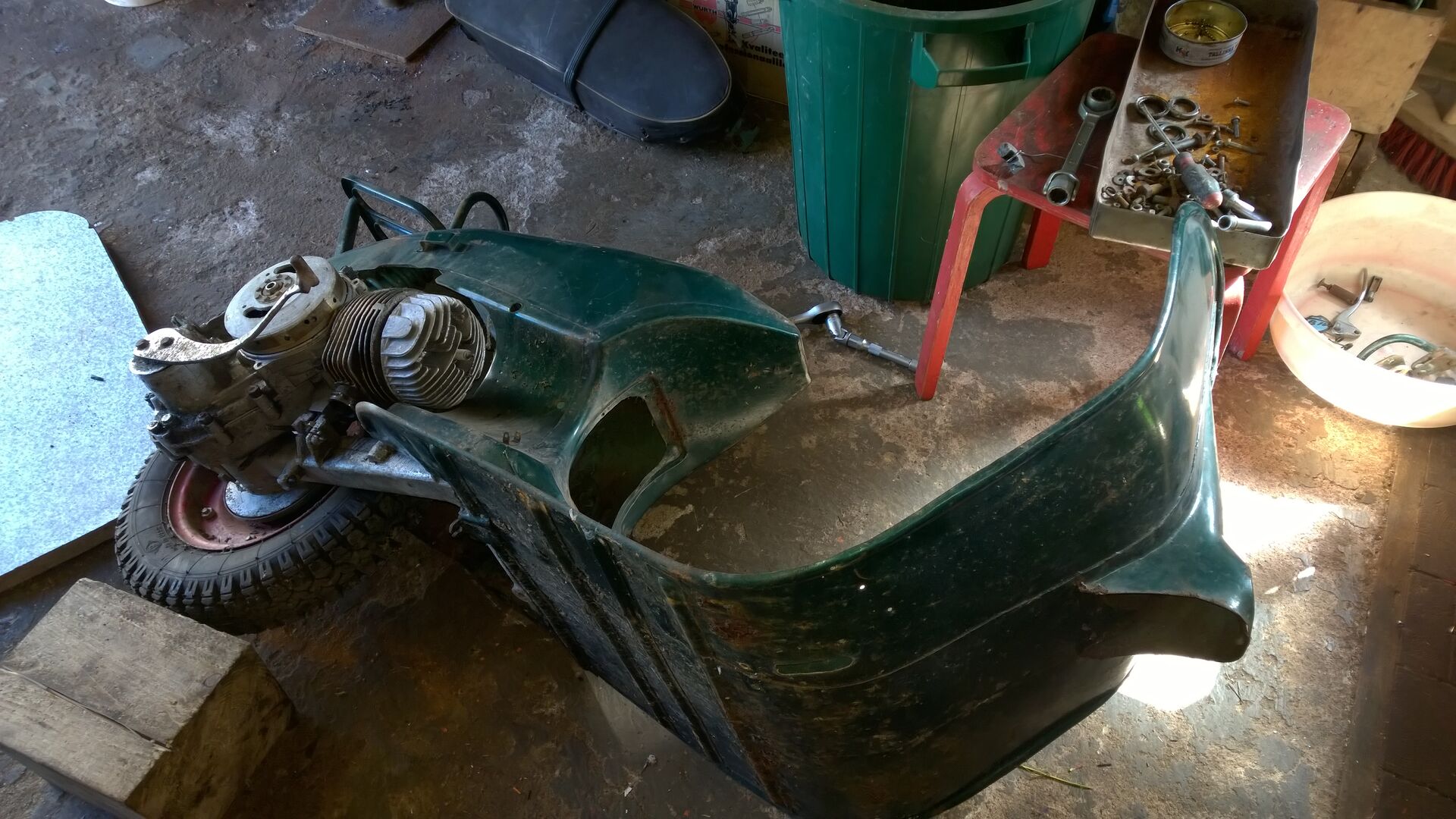

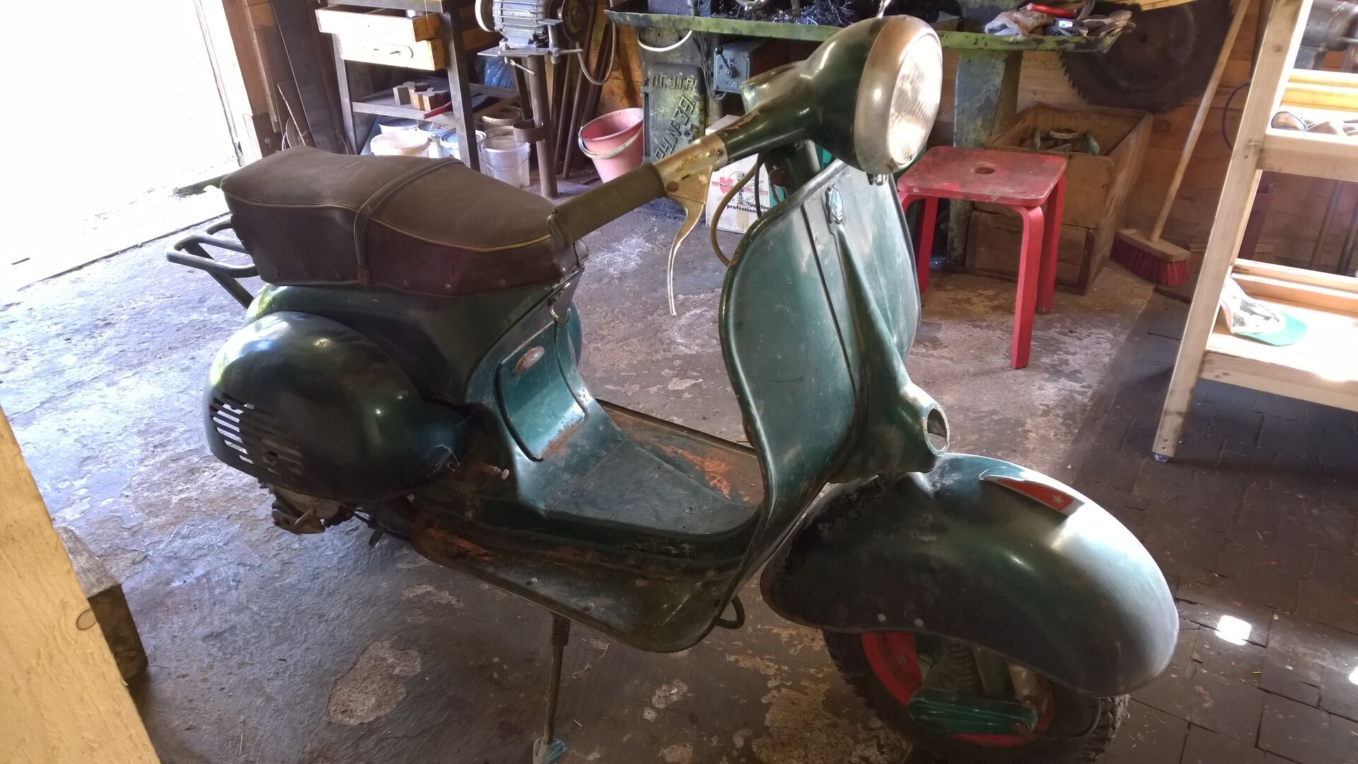

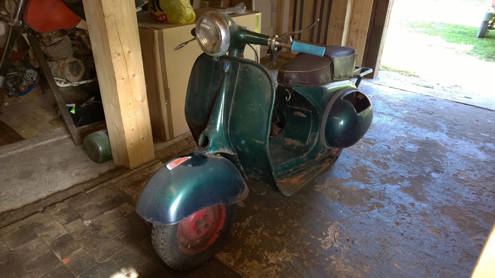

    That (s)he looked when i got it (07.09.2014).

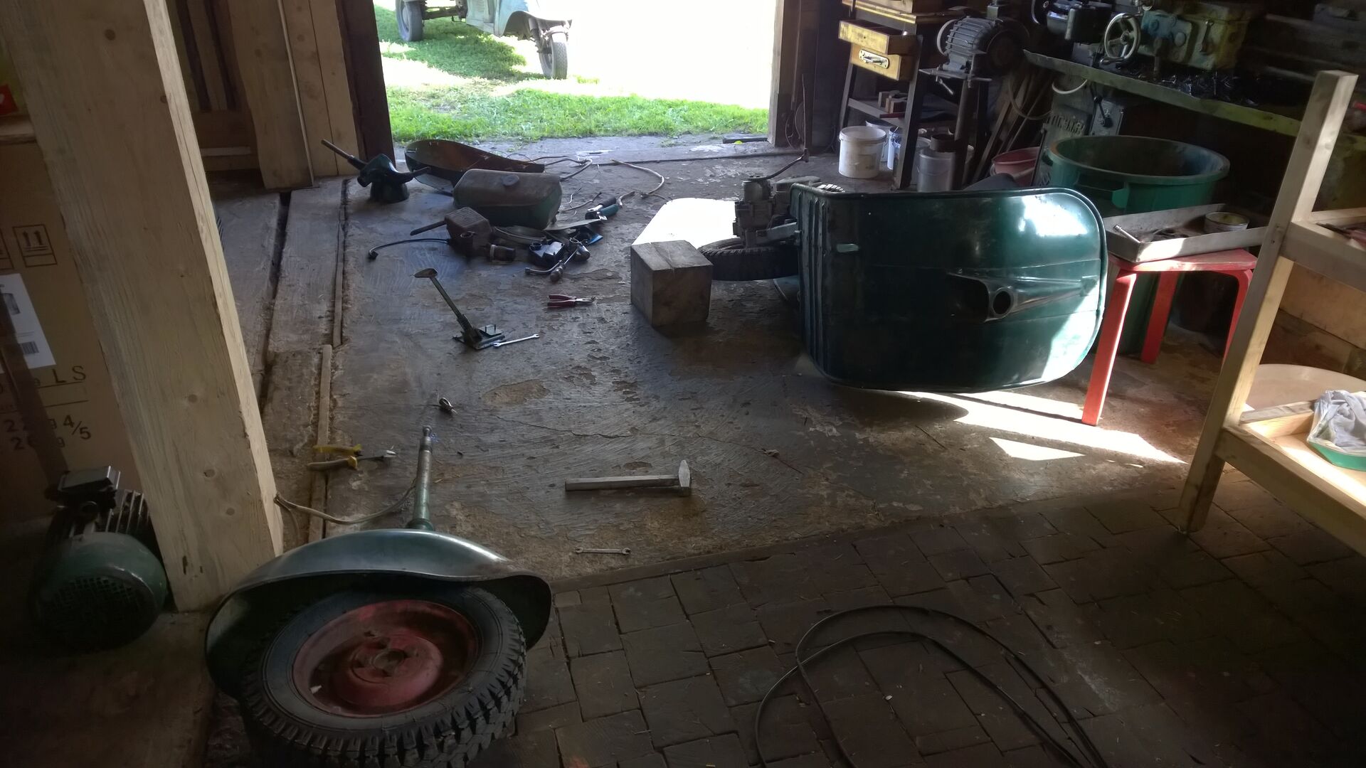

    Next day i took it into parts.

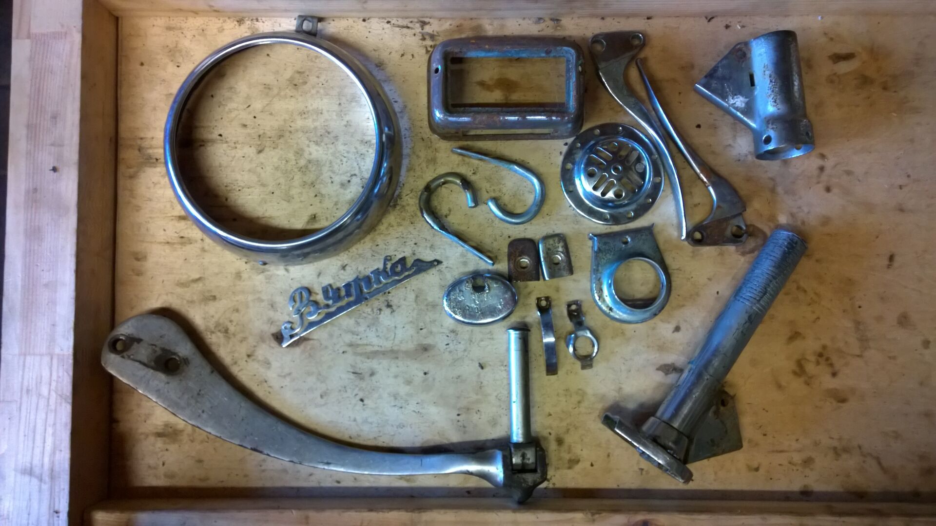

    All stuff is waiting to go to sandblasting and rechromeing.

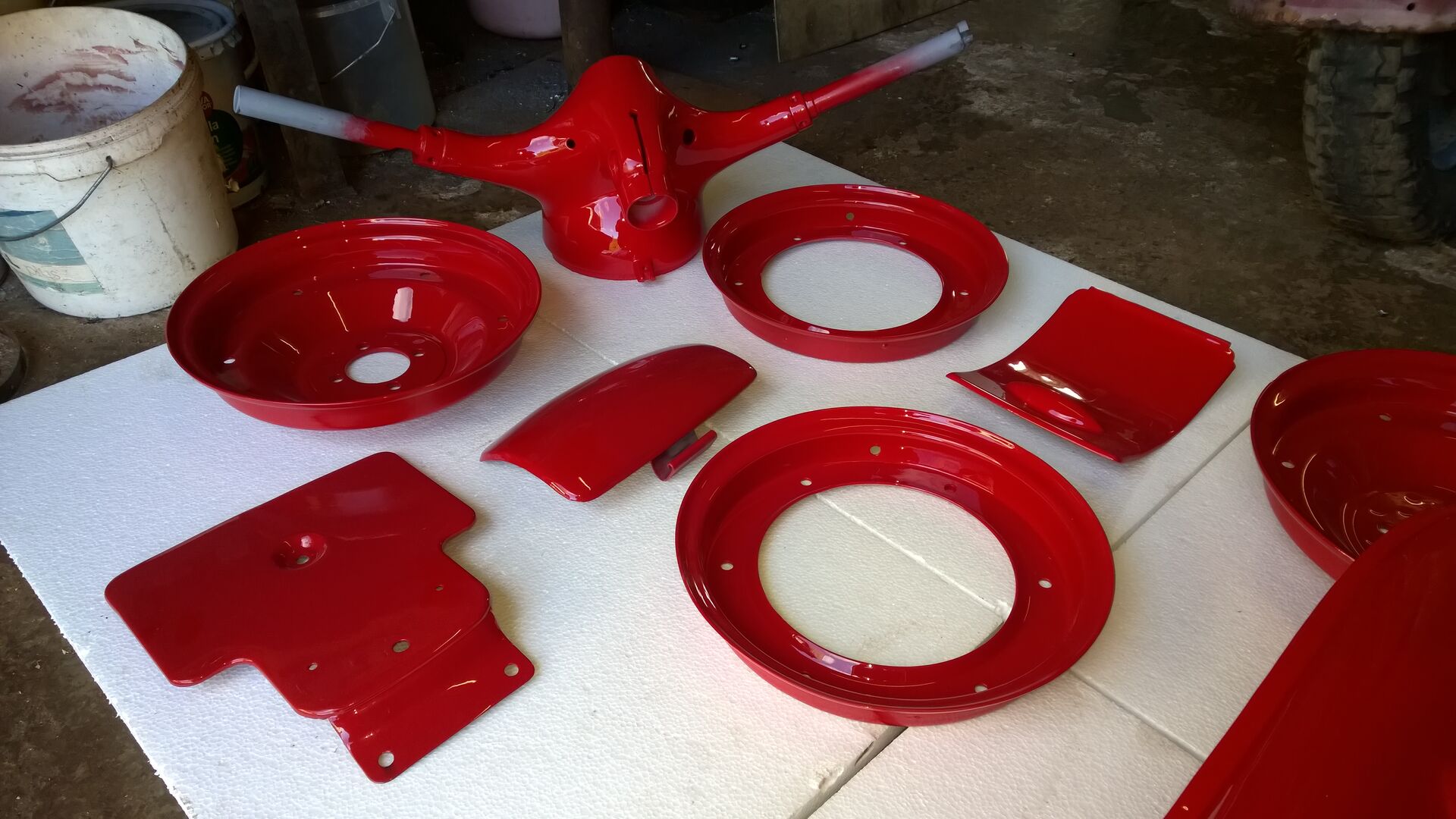

    Cleaned aluminium details.

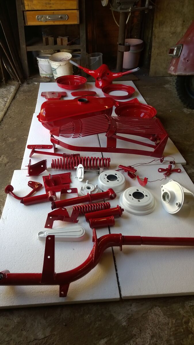

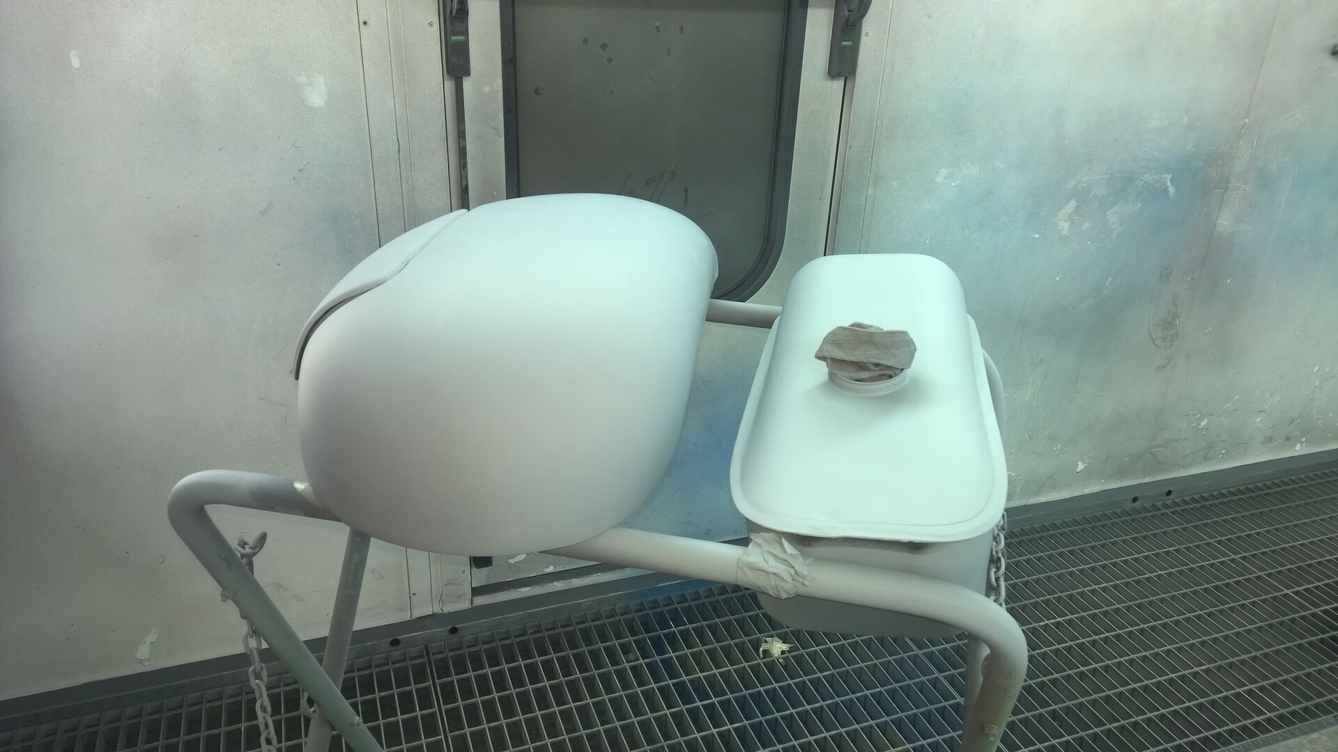

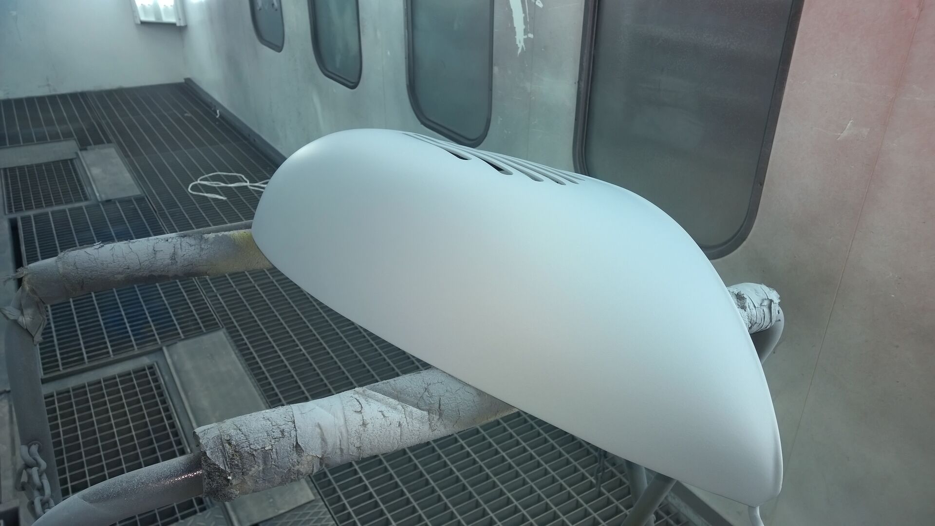

    Sandblasted details paint job.

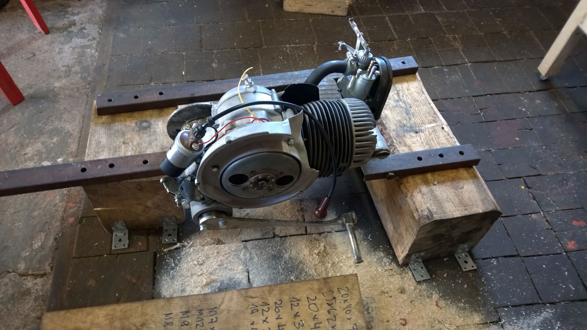

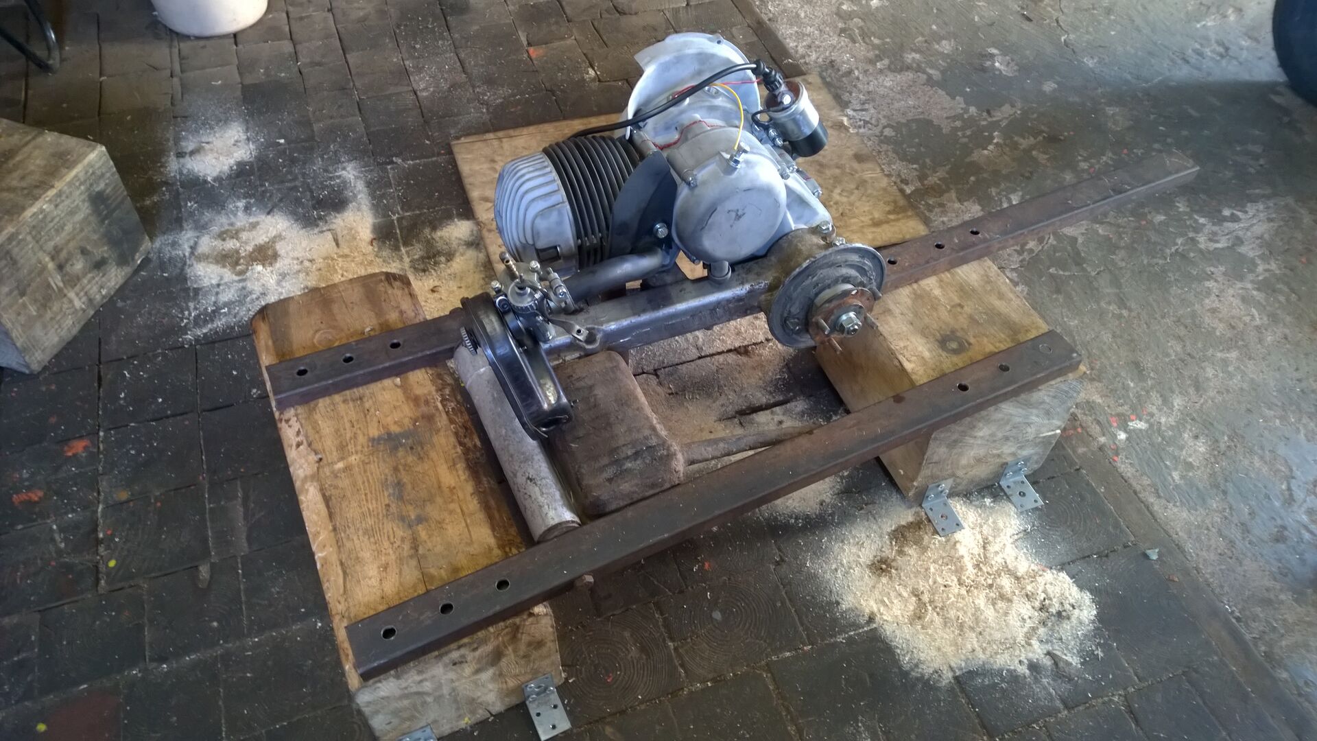

    Previously i built engine stand, where i can start engine. All bearings and oil seals are changed. Engine started for second shot. Here is video.

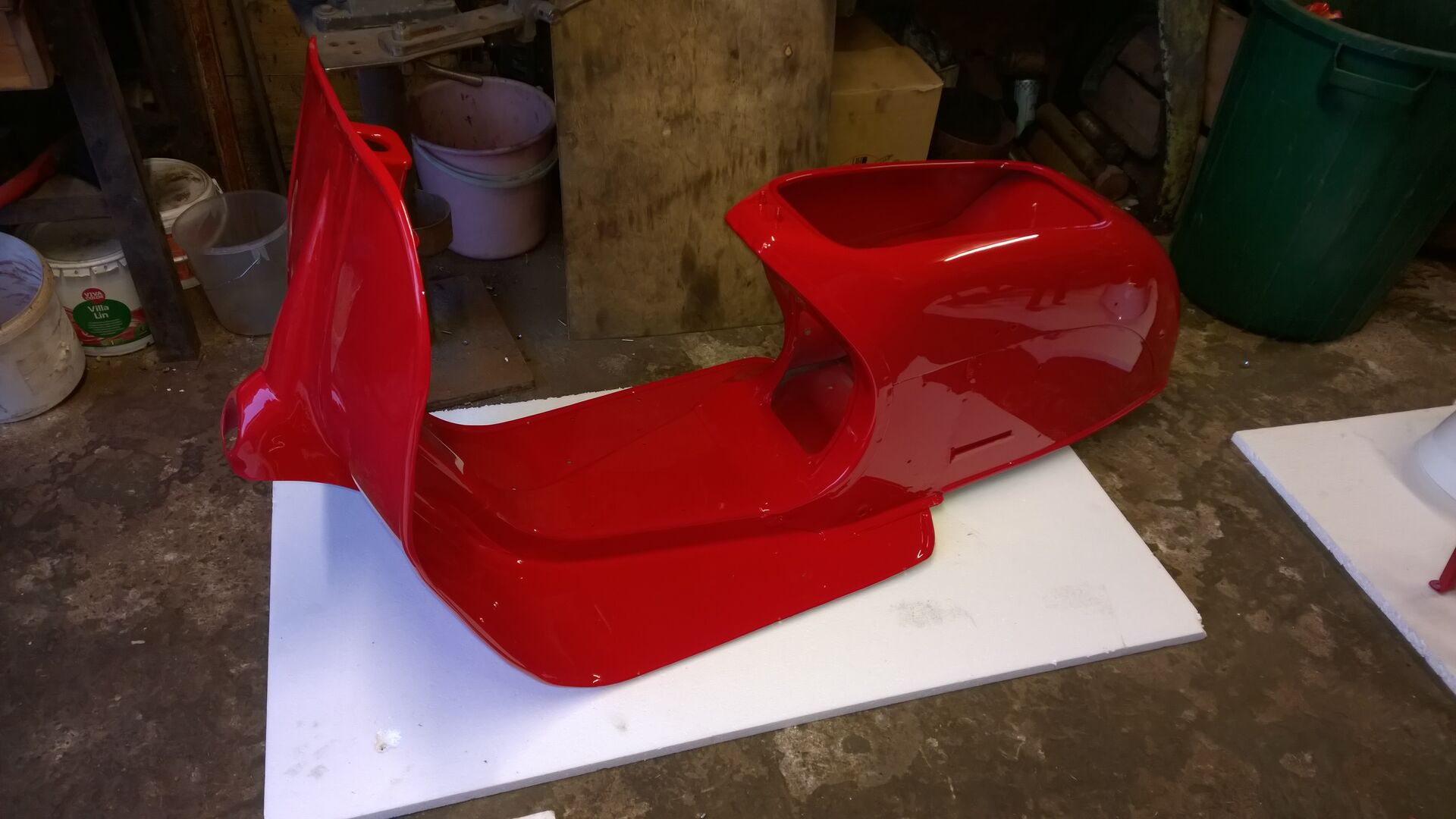

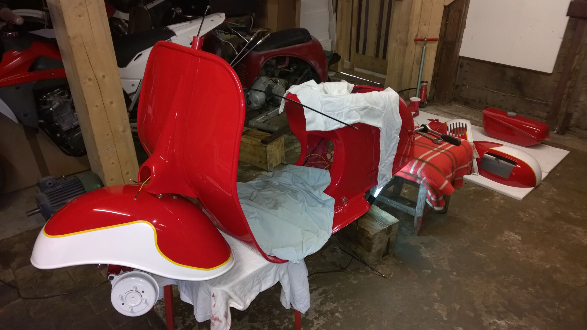

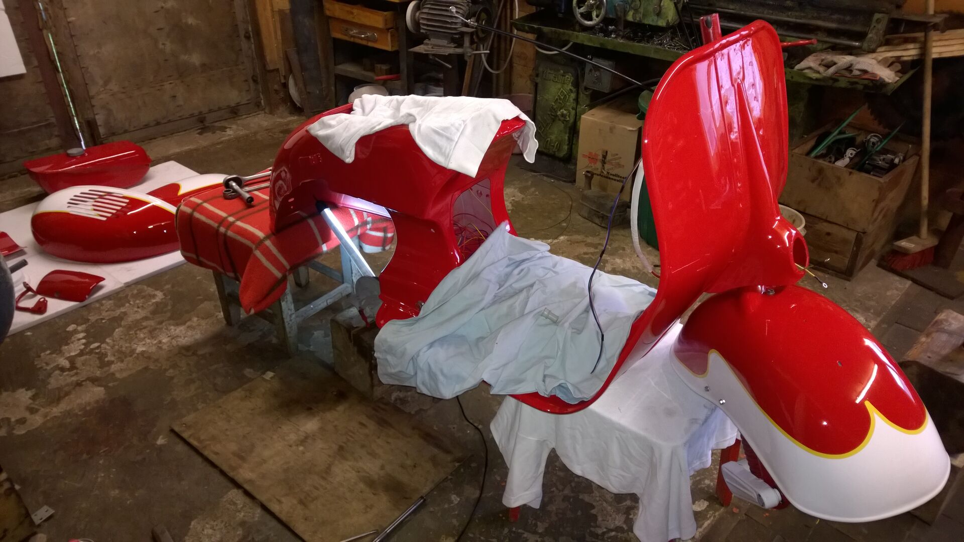

    Paint job is done. 8)

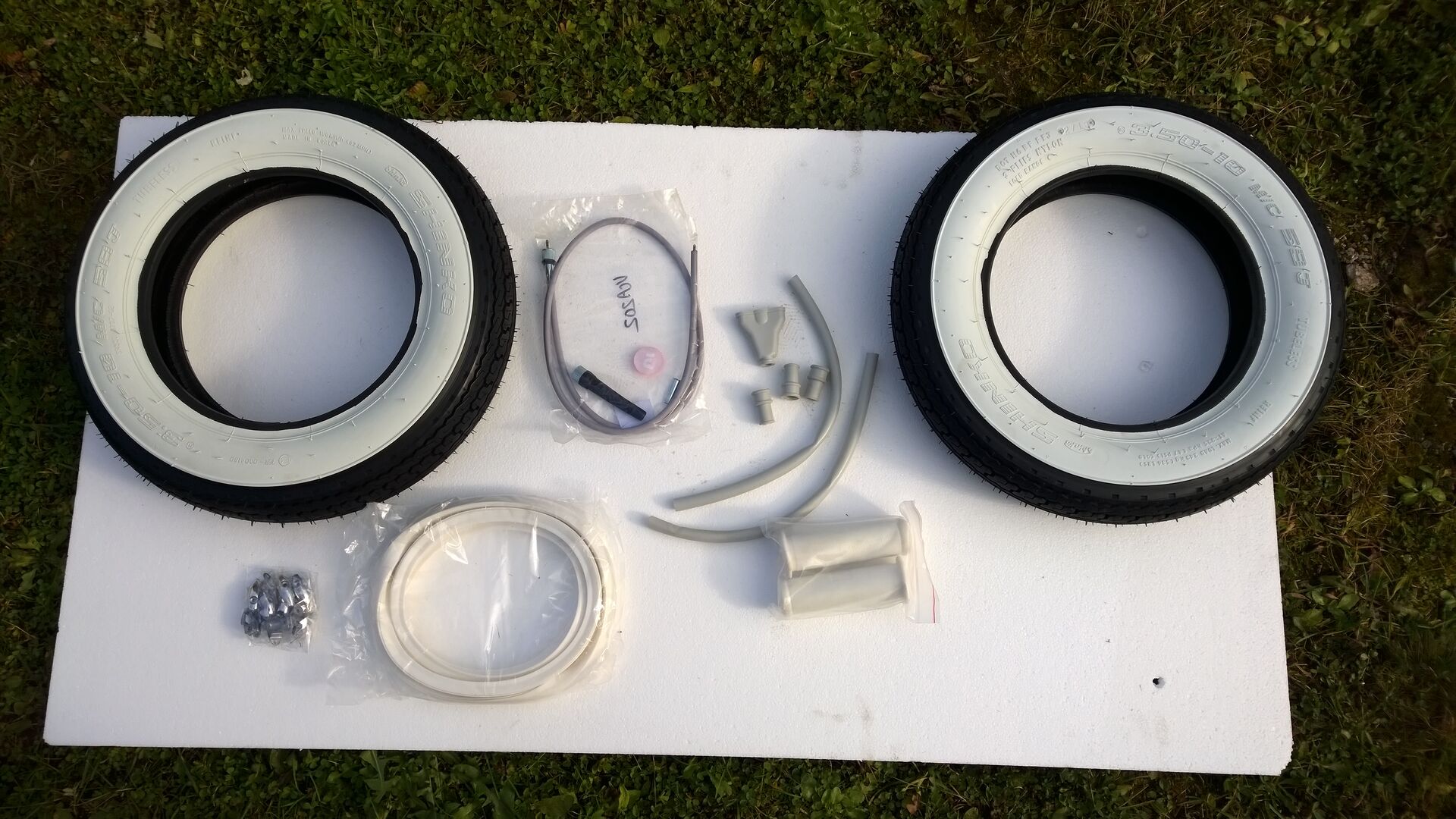

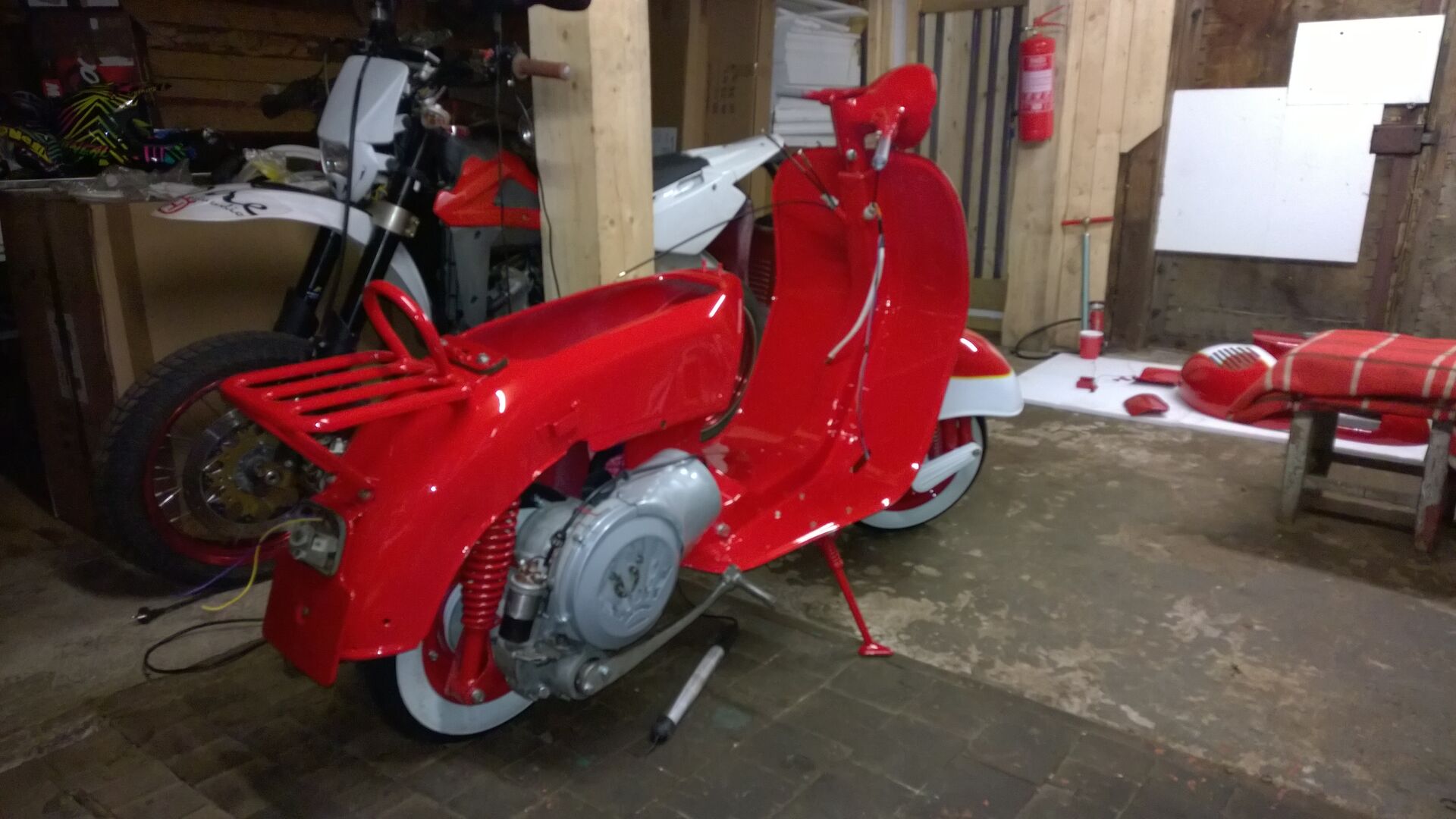

    All new rubber details are from England. These belongs to Vespa, but also fits for Vjatka too.

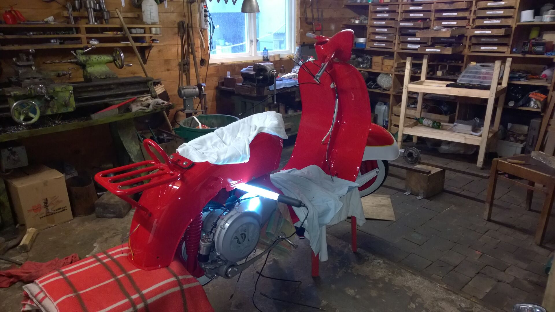

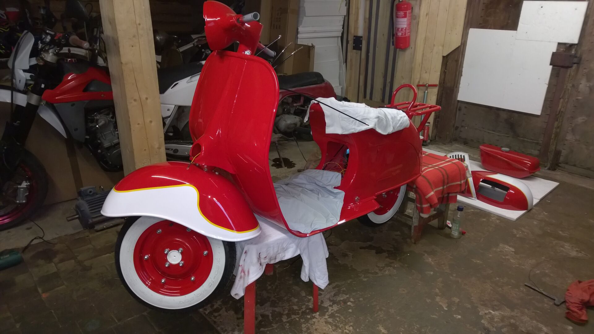

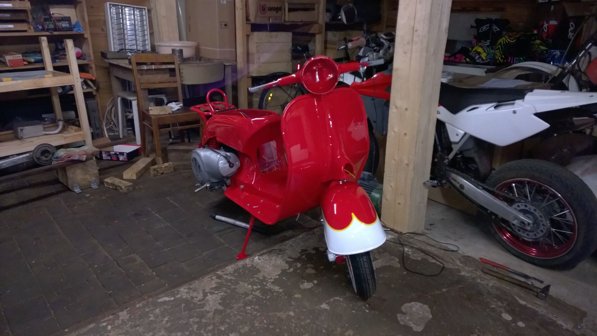

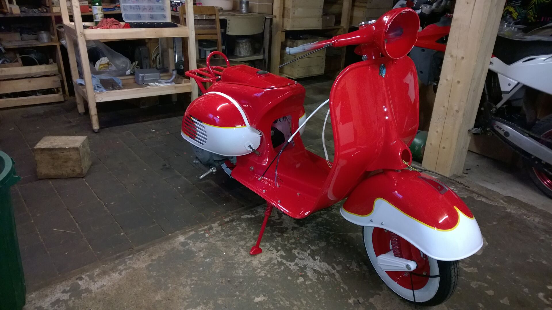

    Began assembling.
    Brand new saddle.
    Rechromed details. Very smood and beautiful.

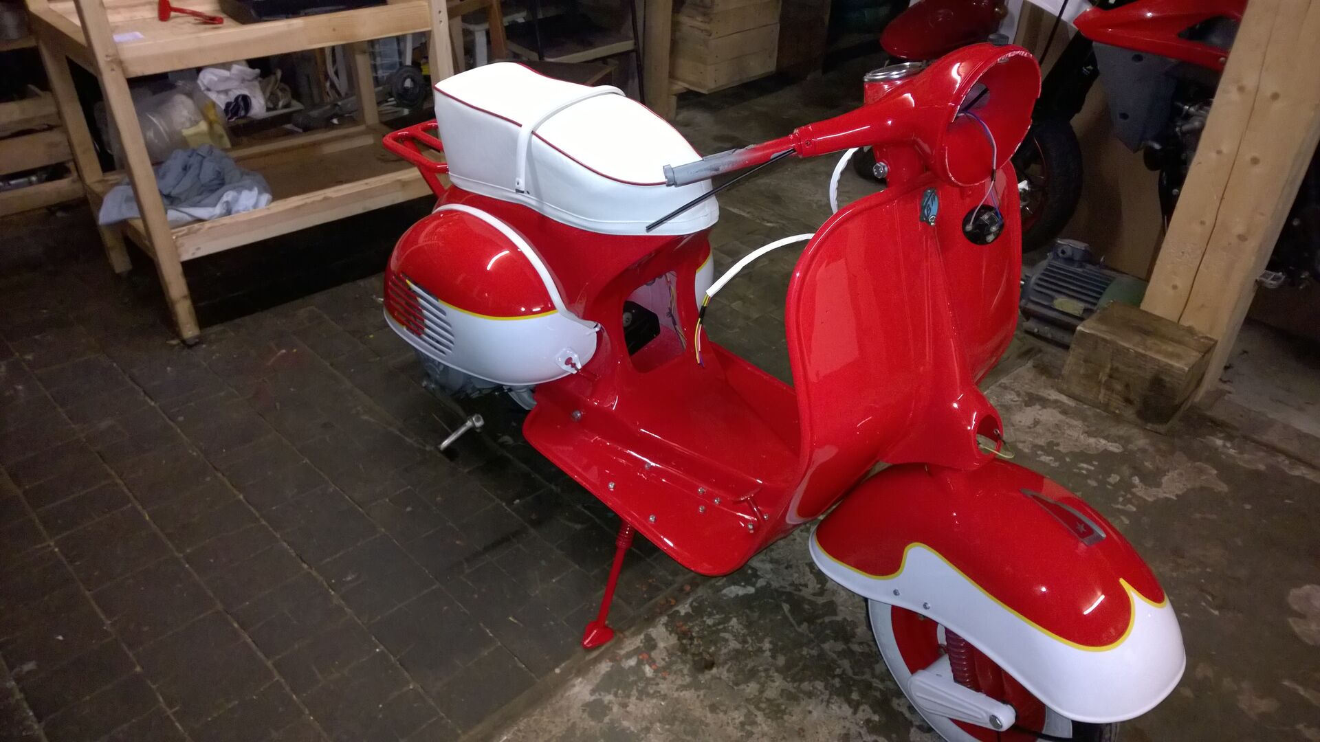

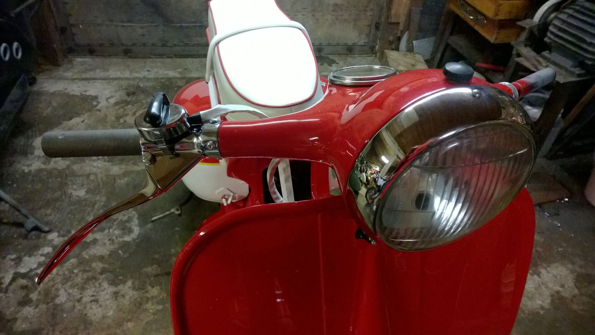

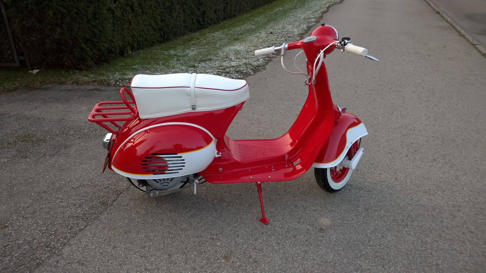

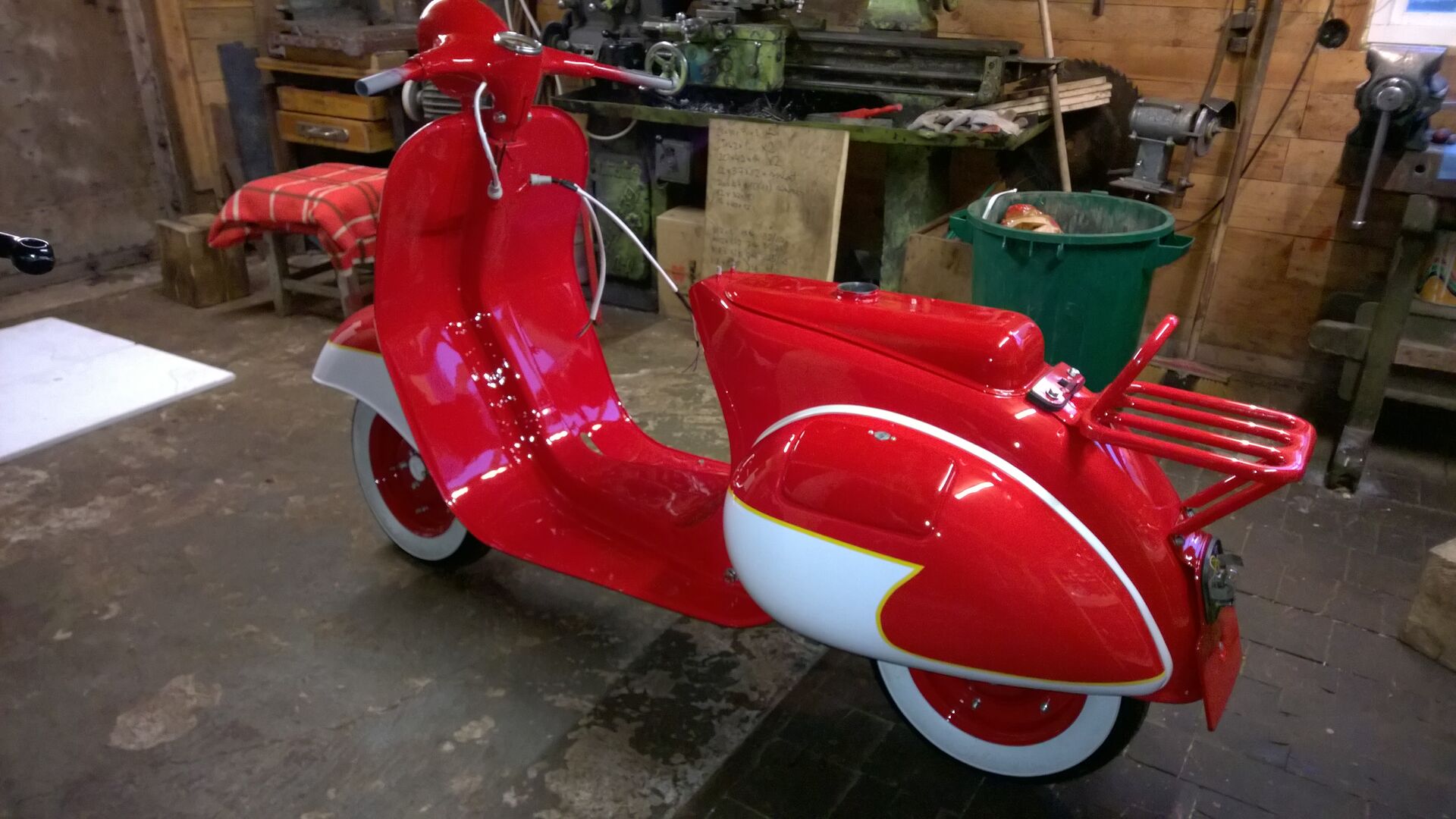

    And it is almost done. Only foot bands are missing (20.11.2014). Now it has an Estonian registration plate and local documents. Street legal machine. :)

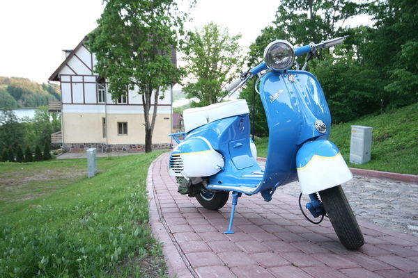

    do you have some other pictures from the blue one restauration.
      • 392.66 kB
    Der Weg ist das Ziel zum Fahren. 2-)
    Einmal editiert, zuletzt von edisvespa (December 10, 2014 at 21:26)
  • opossum9
    34
    Vjatka 150
    • December 10, 2014 at 22:14
    Hey, that is cool. 8) Yes i know this wood industy. I have been in Germany many times, last year i visited my favourite car museum in Munich - BMW Welt. Every year i am going to skiing to Austria, this time Kitzbühel is waiting for me in January. I would like to come to live and work in Germany for one day.
    Btw, blue Vjatka restoration topic is here.

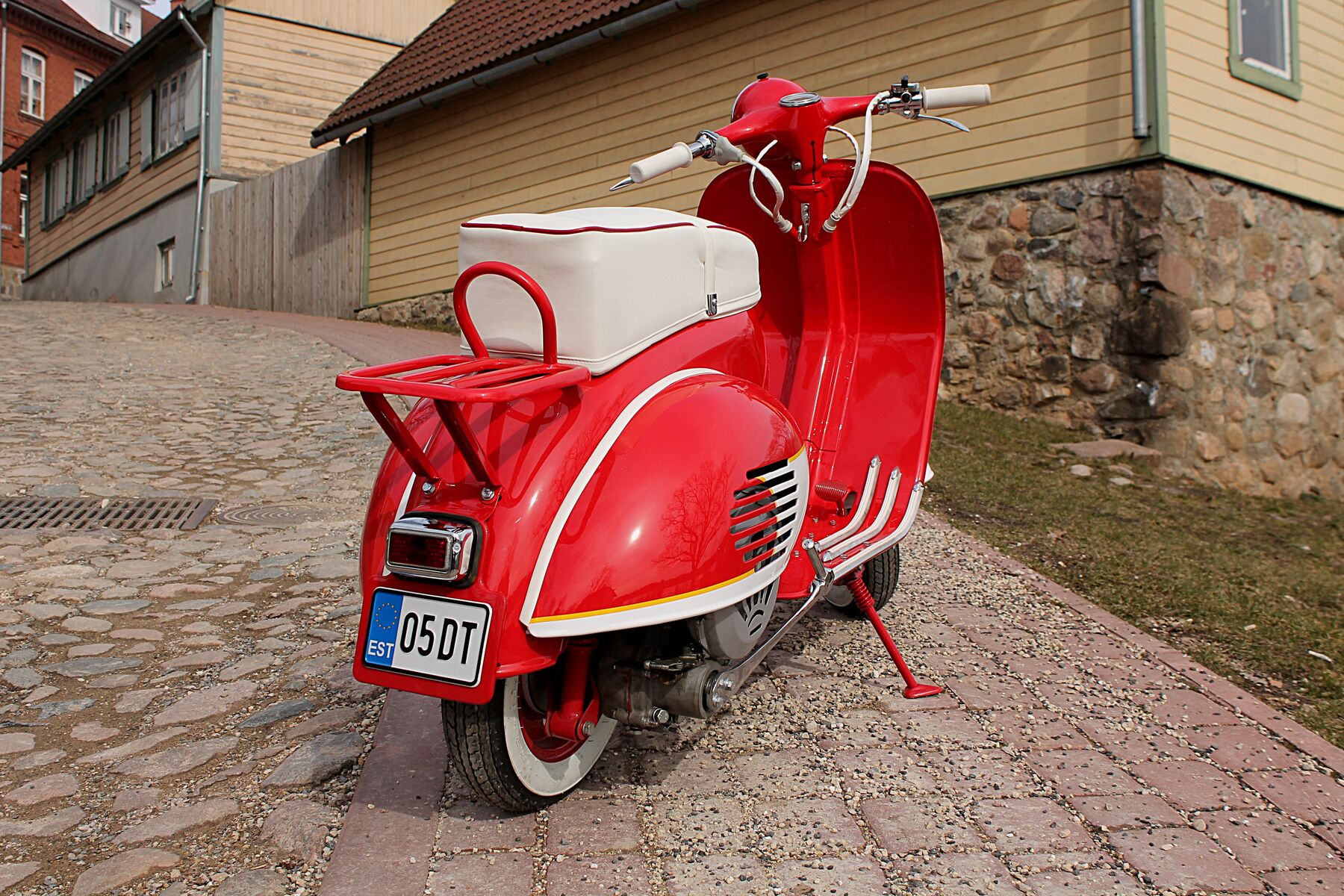

    • March 24, 2015 at 15:54

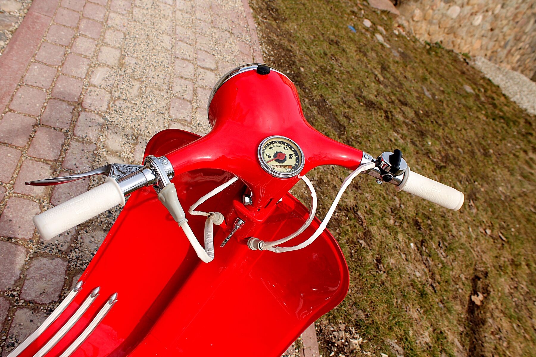

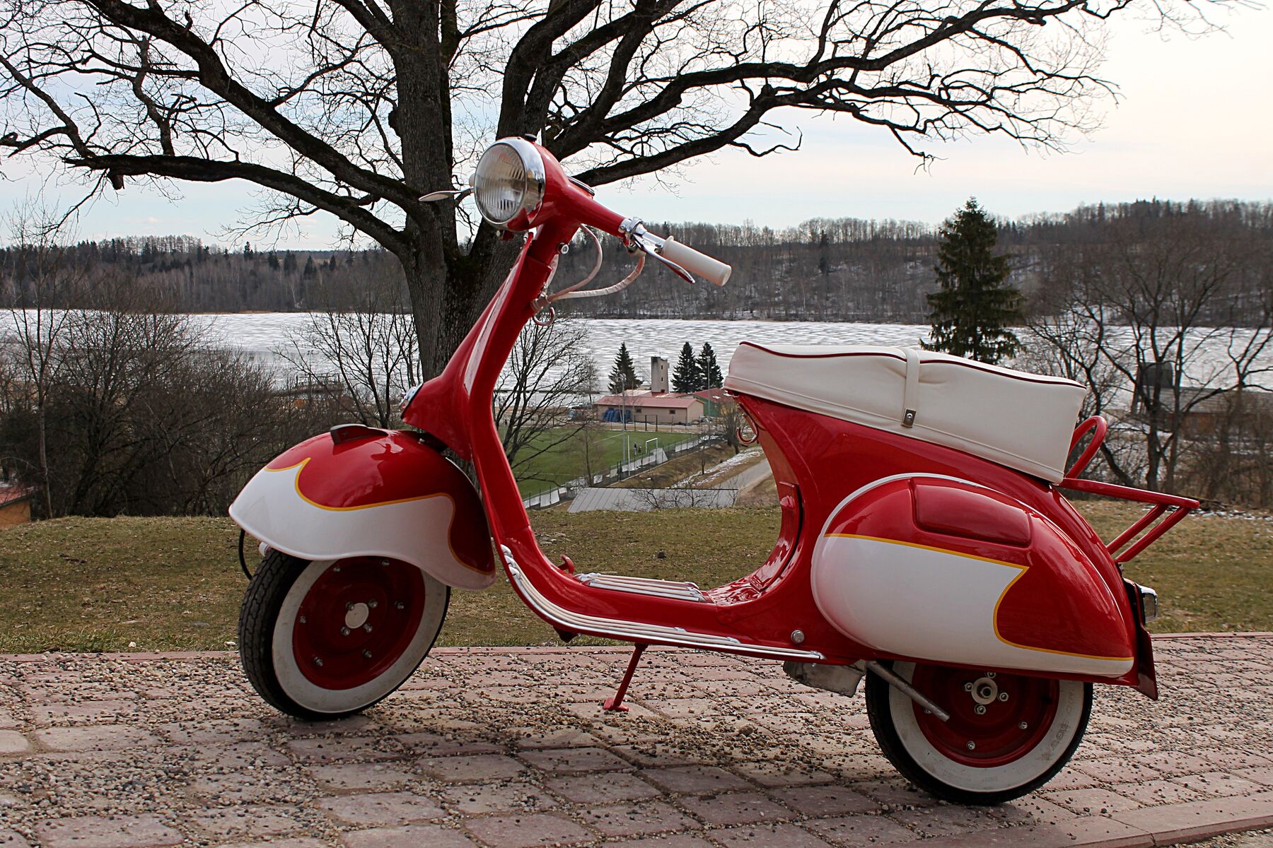

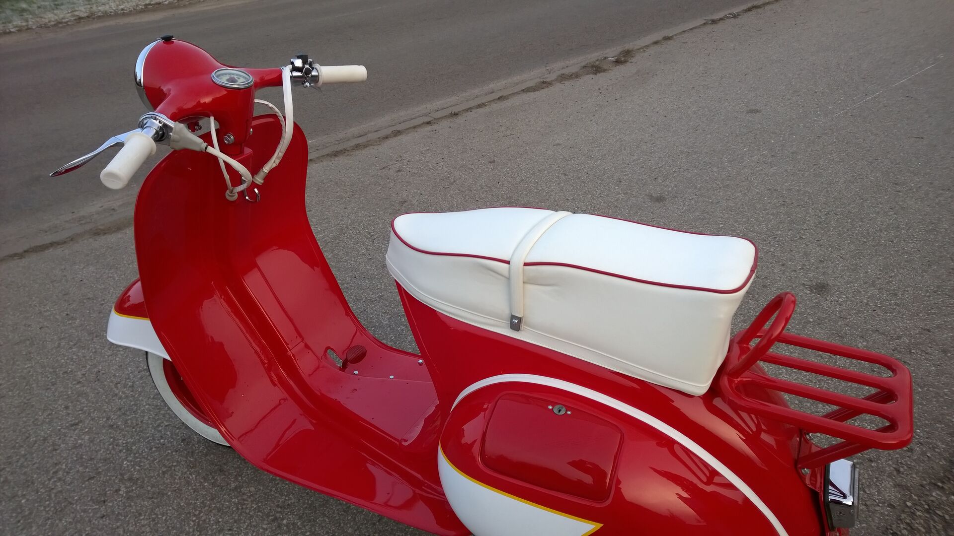

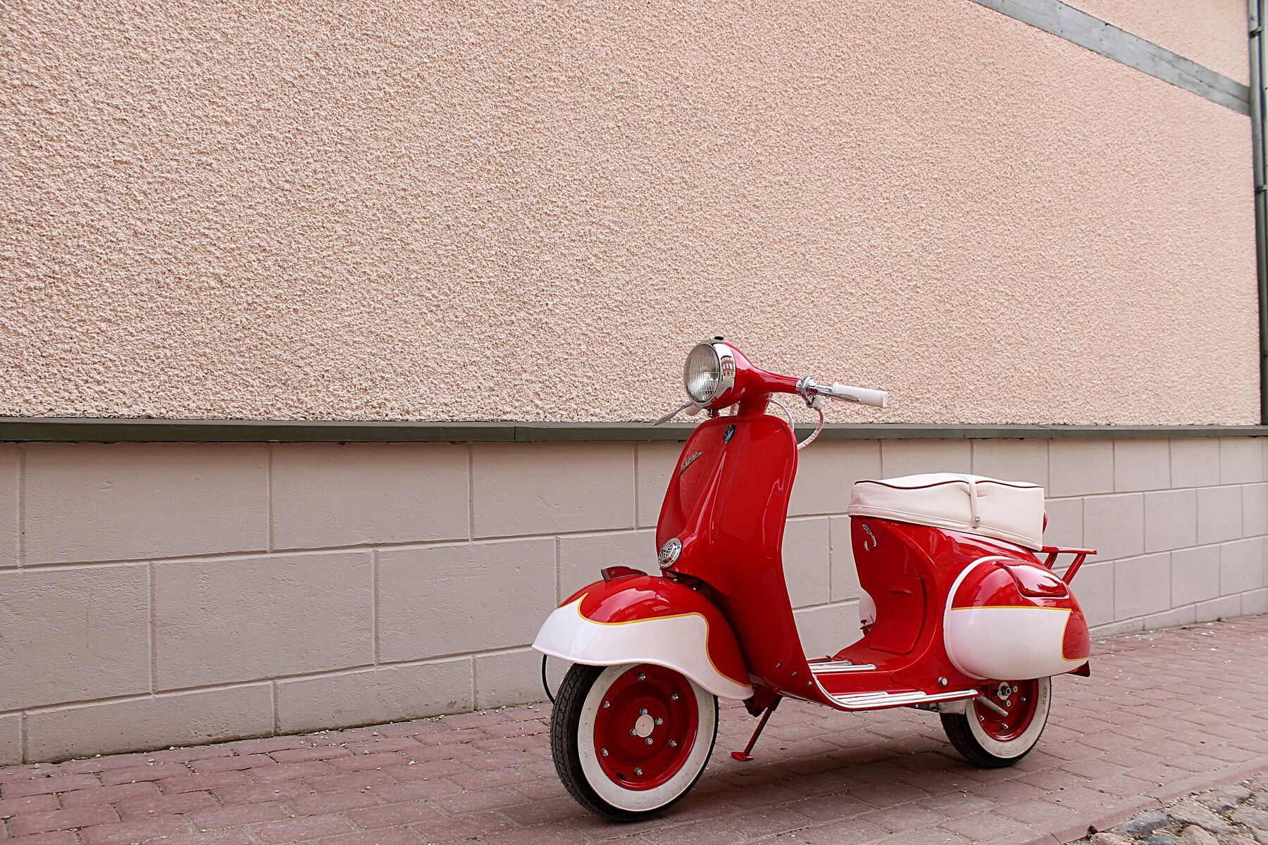

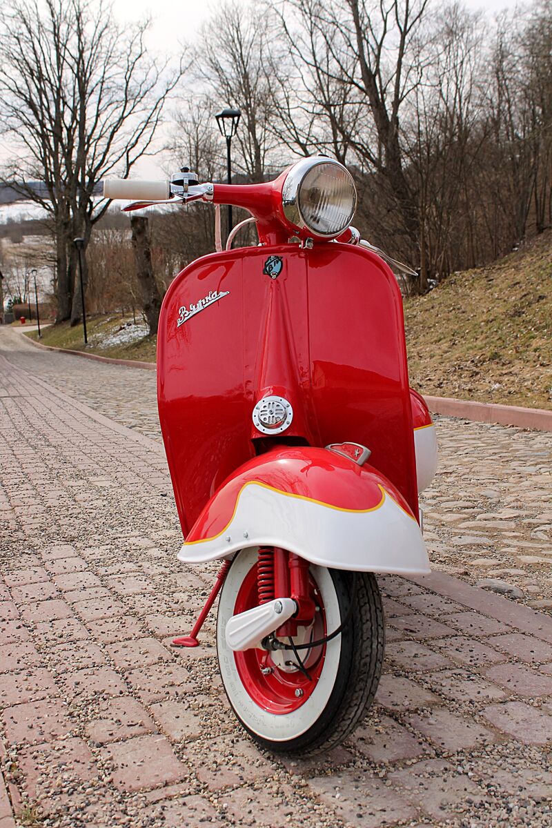

    Has been a long time of silence. Scooter is 100% done and a couple of days ago was a photoshooting. Weather was terrible cold (below 0 degrees) on that time, but last week was 15c and spring. Mystery.
    And me and my beauty. 8)
    A couple of months ago i got a Vjatka three-wheeler. Like this one, but mine is on a pieces. I know one more contact where i can get second complete scooter to build one of the two. These are very rear.
    Remind you, if anybody need some Vjatka parts, whole scooter, these tricycles or my restored Vjatka, please contact me, everything is for sale.
