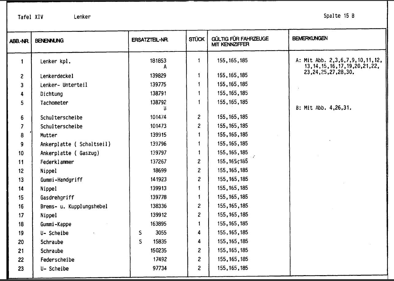

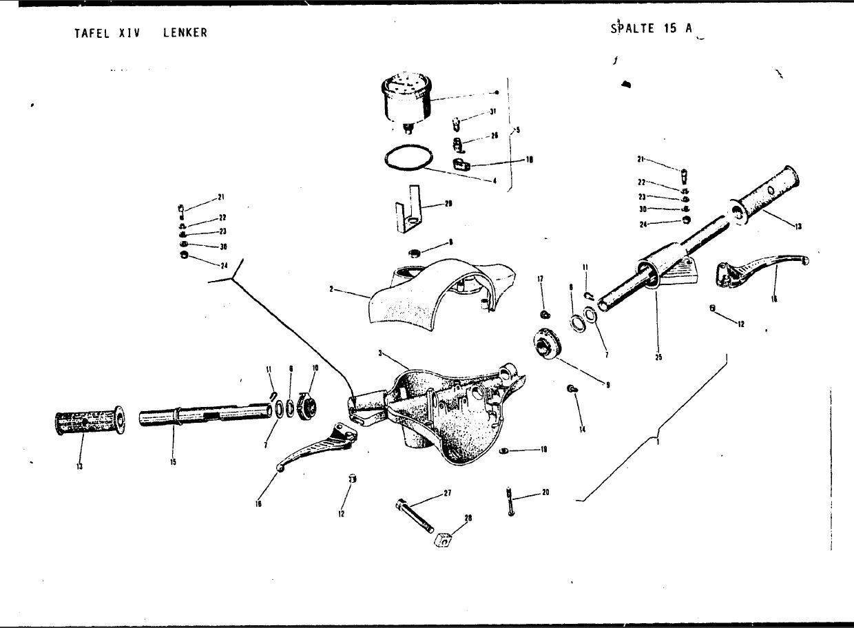

    • June 14, 2010 at 13:59
    Beantwortet das Deine Frage?
      • 83.13 kB
      • 1,240 × 912
      • 199
      • 132.94 kB
      • 1,285 × 918
      • 147
