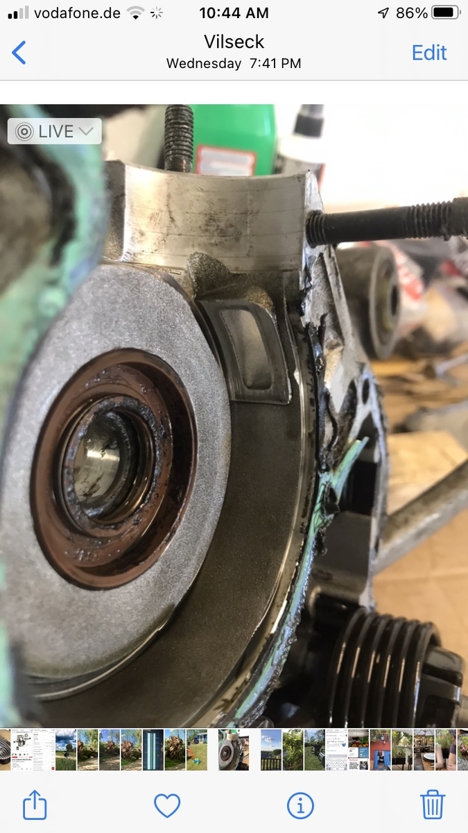

    zeig mal ein bild deines drehschiebereinlasses - hast du den bearbeitet?
    3.0 - reparaturkit sip Part no.: 16033500 verbauen, sonst fliegt dir die primär um die ohren.

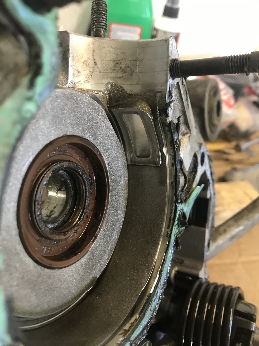

    • May 26, 2022 at 07:53
    • #44
    Regards,
    I ordered a new ignition as there was black soot inside the flywheel and the ignition coils were coated leading me to believe the ignition is faulty and may have played a role in the seizure.
    The dr 130 was recommended to me by two people who seem to know what they are talking about. What would you recommend? Do you think SIP will take back the device after the box is opened?

    You have the small rotary inlet. This should be enlarged to have the optimum power output. If it can't breathe - there will be no power.
    If you mount your crank You can mark how far you can go without destroying the seal - the recommendation is to have about a mm of Aluminium around the enlarged hole left. Take care of the clutchside of the inlet: the the sealing side of the crank doesn't reach the housing so don't go too far.
    The other option for more power would be to use a polini reed valve aspirator for your designated carburetor. If legallity isn't a major concern I'd suggest using a dellorto phb 25 with matching rubber-sealed aspirator. This works very fine and is good for more than 20hp.
    The next two limits are the cylinder and the exhaust -
    My favorite cylinder for plug and pray is the polini 130 or the malossi 136. as an exhaust unlike the polini banana. We use that in European scooter challenge for a long time - the engines have about 12-14 hp and are very good For Daily use as well. With a Bit of grinding you can reach up to 16hp

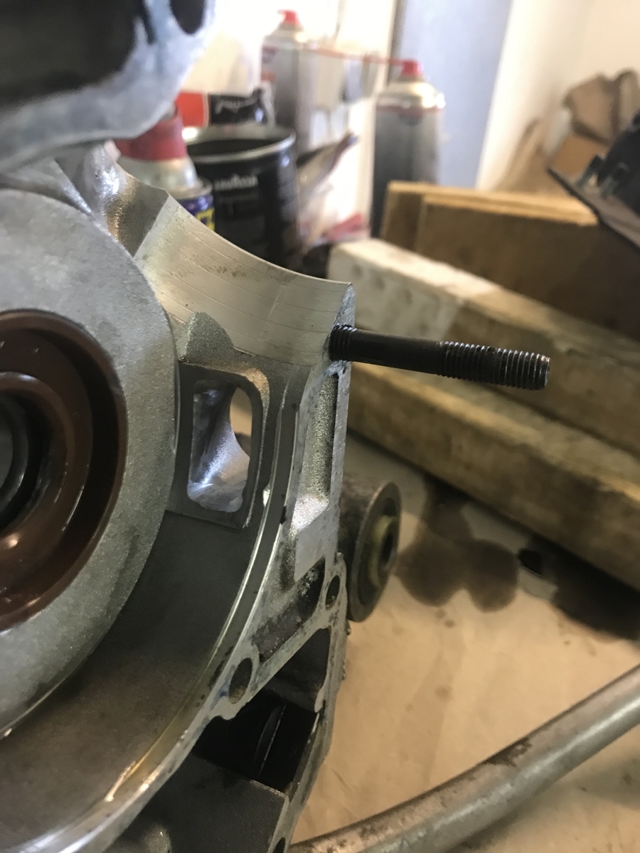

    :-7 :-7Ich wollte nur die Vorher-Nachher-Fotos zeigen. Ich habe den Einlass nur mäßig vergrößert. Ich fand, dass die runde Handfeile besser funktioniert als der Dremel und auch eine bessere Kontrolle bietet.

    • May 31, 2022 at 21:08
    • #60
    So ungefähr. das ist mein aktueller Einlaß:
