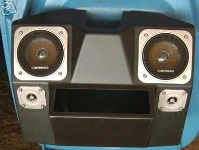

    • May 24, 2006 at 10:08
      • 19.34 kB
      • 400 × 302
      • 599
