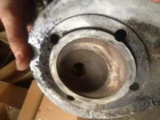

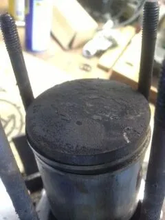

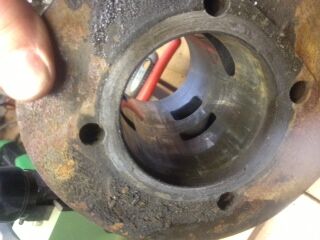

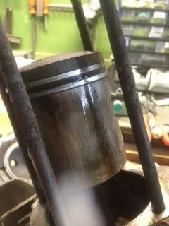

    • April 2, 2013 at 12:21
    • #60
    um mal was nettes zu schreiben - was bisher so zu tage kam sah ganz nett aus
