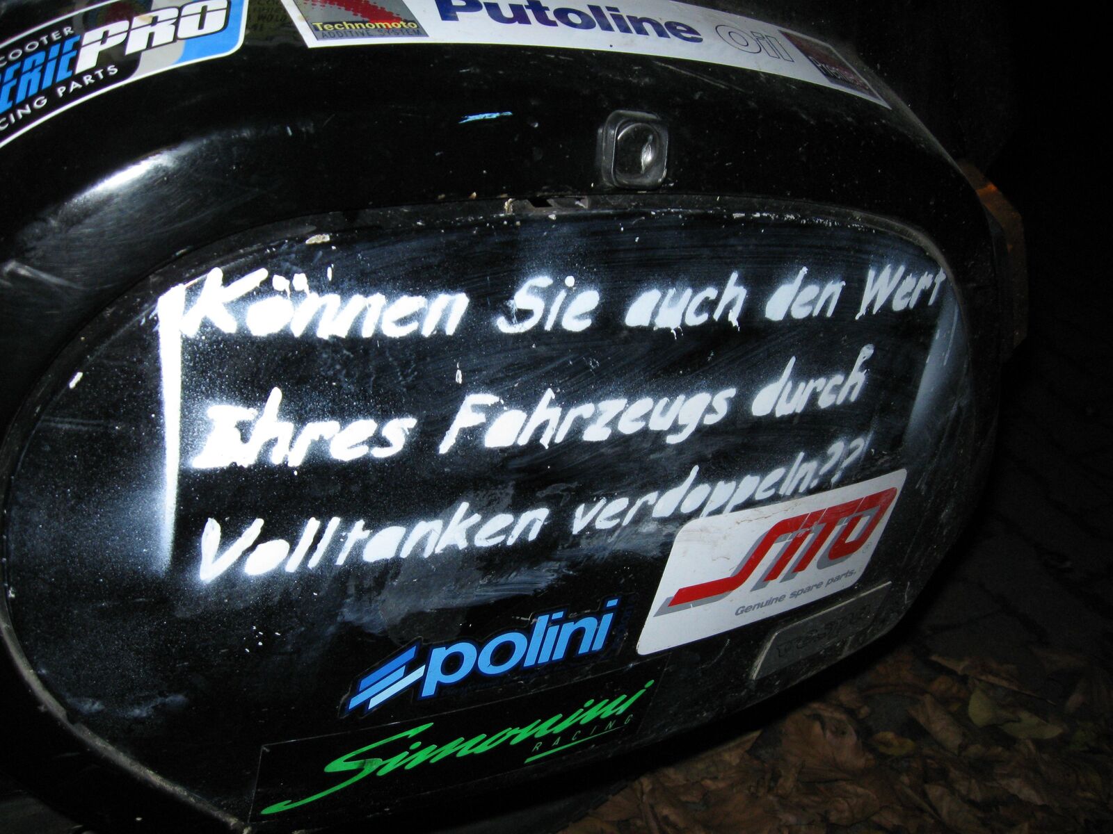

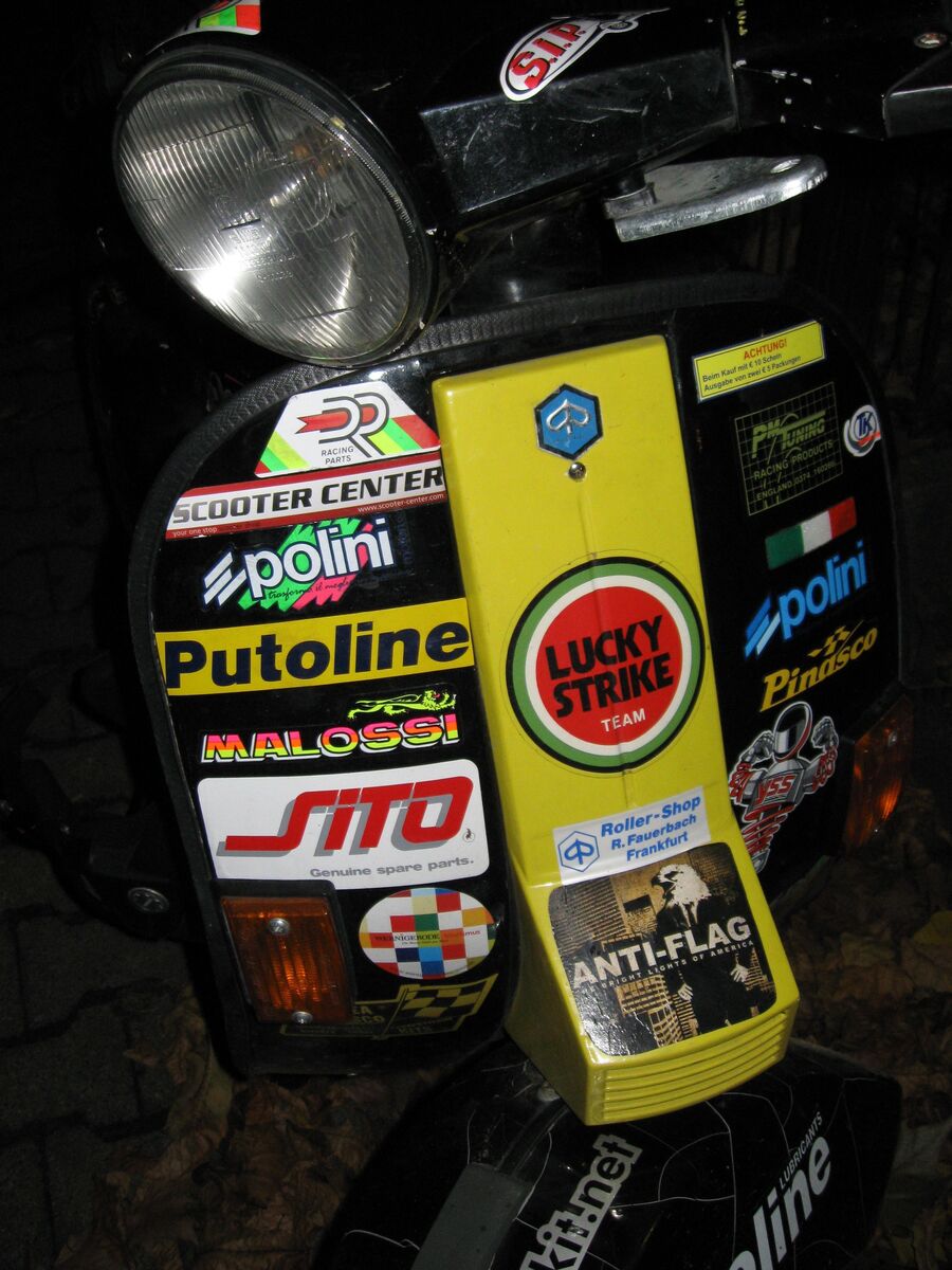

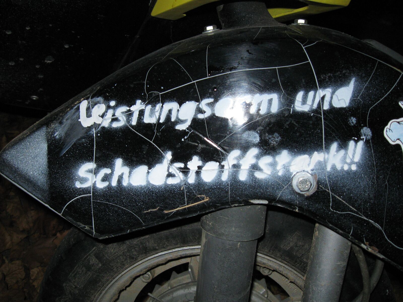

[gallery]4904[/gallery]
[gallery]4905[/gallery]
[gallery]4906[/gallery]
[gallery]4908[/gallery]
